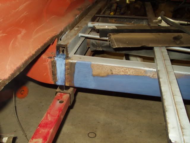

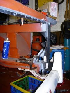

Start with the nearside front outrigger top hat and jacking point

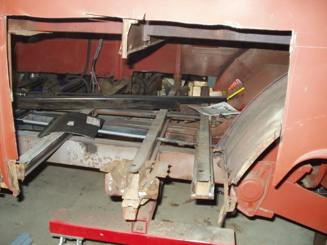

Then remove the rear side panel

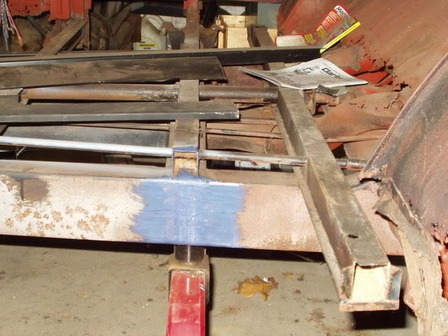

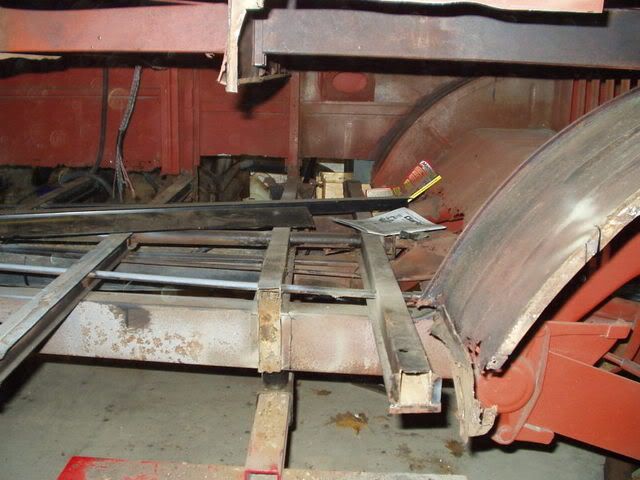

And then off comes another outrigger, and around a kilo of South African sand falls out

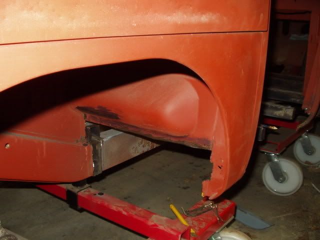

Then the whole side panel; comes off....to be replaced by this Brazilian single cab panel cut to size and an NOS corner. I'm going for louvered side panels instead of the South African vents. Once I've put a new bed on there's no way I'm cutting any more holes in it than needed!
All cleaned up ready for some more of Mr Schofield's finest sheet metal.

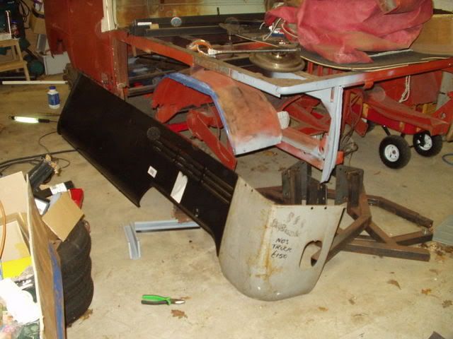

Collected a load of Gerson's panels off musclebus last night....still a few more to come. The number of excuses as to why I'm not moving faster with this are shrinking by the day.

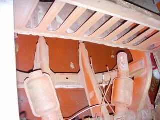

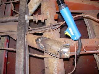

First panel to go in is the new riser panel above the rear torsion tube. Need to fill this gap - also need to fix the heater pipe.

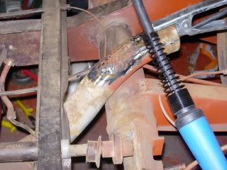

Neat repair to the heater tube - before (worse than it looks)
After - almost done

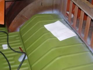

Then the new panel - hand made, unbelievably good fit. Laid the floor in just to get the sloping panel at the right height.

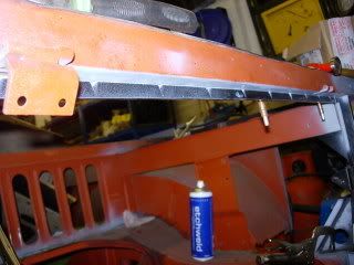

Today the perforated seal engine compartment seal retainer got swapped for one cut off an NOS Brazilian panel

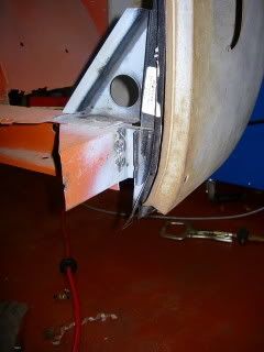

A new support pillar also went in - looks like it's for a late bay, will need a bit of trimming at the bottom edge
Looks fine until the rear quarter goes on...
Trim a bit off the bottom, and we'll be in good shape. Leave it as it is, and it will spoil the line. Both rear corners and the valance are NOS, so it can't stay as it is. Turns out the NS support pillar is the same - the bus had a bump at some stage, and a later pillar was put in - this side will get the same treatment as the OS one.

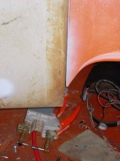

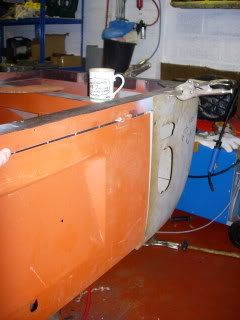

There's a bit of fettling needed to get the battery tray to fit, then the rear corner can go on - it's an early bay, so fine here...
But a bit of work needed here to get the line right.
The nearside will be a bit easier, split NOS rear corner, and an NOS pick up platform tray!
