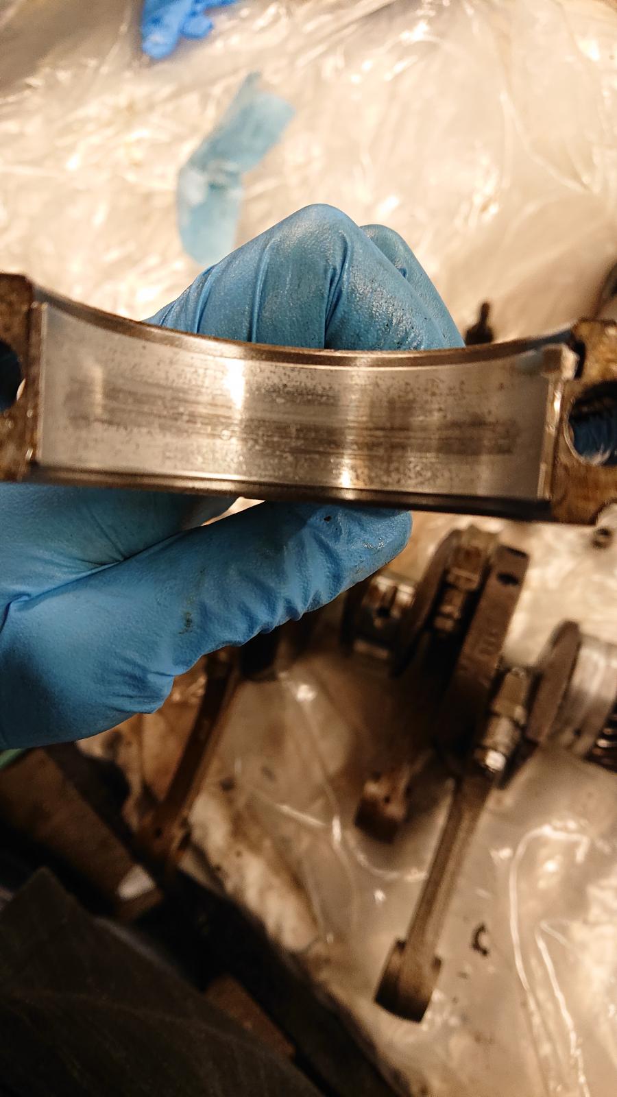

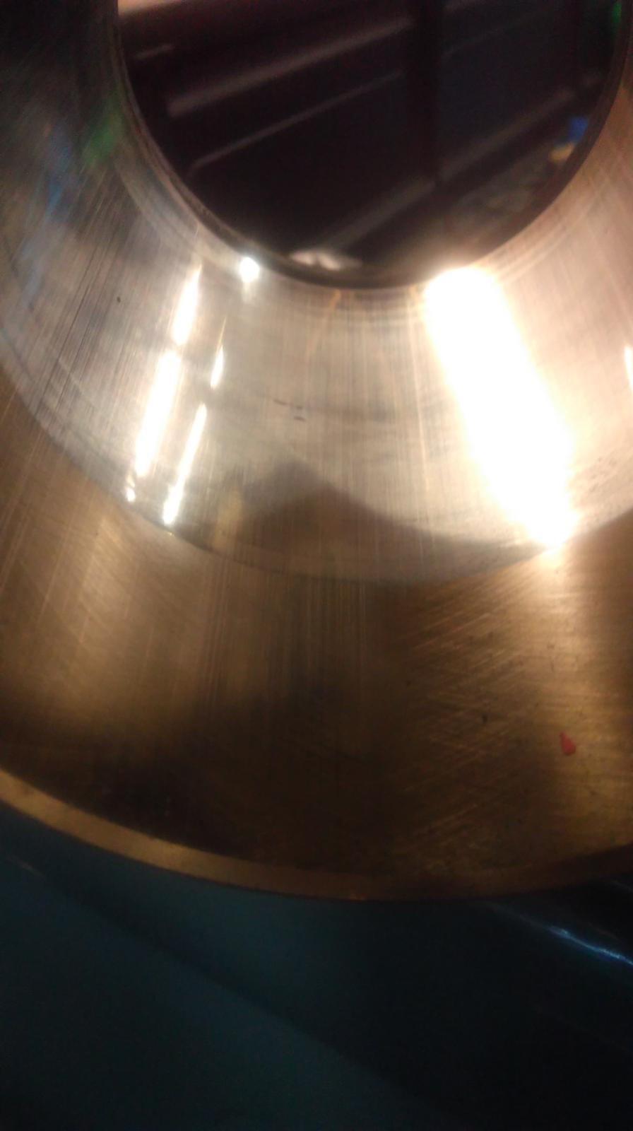

Haven't updated this for almost a year, so I figured I'd add something for the record.
The engine is out, completely stripped down and the case and crank are off for machining at the VW Engine Company.
It never ran right. It had all the symptoms of valve overlap, but it was a P.O.S and clearly no one had spent any money on it, so it couldn't have a performance cam in it, right? I'd convinced (deluded?) myself that was the case and had concentrated on the fuel and electrical systems to try to cure the lazy starting, rough idle and timing issues, but it turns out I was wrong.
In the course of stripping it down I found that the pistons and cylinders were scuffed and all the bearings were pretty scored, most likely due to dirty oil. The crank is scratched up too. This thing didn't even have an air filter element in it when I got it and god knows how long it had been run like that.
With the cheap, broken tinware and other rubbish aftemarket parts it was clear that it hadn't been looked after.
Strangely though, whoever built it decided to fit an Engle W110 performance cam. That, coupled with a single carb and standard heads and rockers probably explains the issues that I'd been having.
So now the fun part. Rebilding it to stock. Hopefully easy to maintain and predictable.
